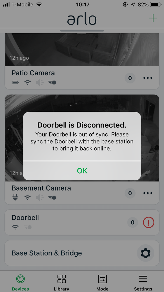

The doorbell doesnt sync. Even after resetting base and doorbell! Help!! I was on the phone with customer support for 3hrs!! Nothing solved! The cameras and base sync great! Not the doorbells or the chime tho.... please help

Make sure the base firmware is up to date. Press and hold the doorbell sync button for at least 10 seconds and try to sync again. It's possible you have a bad doorbell and need to swap at the store.

Same issue I have. Doorbell was working 1 week and now goes out of sync. I can delete it and add it back to the station, just to go out of sync after an hour or two. Any solution ot I need to replace the doorbell?
What does the doorbell WiFi connection strength look like? This may be due to a weak signal or 2.4GHz interference.  Of course, it could also be a bad doorbell.

Hi, the signal is strong, full.
I have Arlo base connected to Google Mesh and I did move one from another 3ft. I also bought wall mount for google mesh unit so I will put it high on the wall and will leave Arlo base on the cabinet. Will see. Adding the doorbell back to system is also not possible by simple Sync on the doorbell. I need to remove bateries and add it from beggining. This worked on second time I tried.
I also have issues wirh bateries going down to 20% within 2 weeks. I just bought the new Energizer Lithium ones and will see. But I do not believe that it will help a lot if any.

What helped me was:
1. Moved the Arlo Base station do other room so there is not Wifi Router between Arlo station and Door Bell.
2. Changed the batteries to new one (regular ones which I had in home)
3. Reconnected doorbell due to baterries change
All above helped. From my original post till now no single issue. Also bateries are now 86% despite of winter temp in Colorado.
Despite this issue being resolved I need to say that price tag for this product is too high comparing to the problems you need to resolve by yourself and marketing overselling Arlo capabilities ( enhanced DoorBell notification from lock screen and geofencing issues). Good luck!

Hi
In reference to #3.
Because lf course I could not resymc the DoorBell I removed it from the App totally. DoorBell -> ....(right top corner) -> DeviceSetting -> on the bottom Remove Device.
After this is done and your batteries are new (best would be Lithium) and Arlo statiom is moved to other place, please add the DoorBell again following Arlo procedure..
BTW: Even this procedure ends for me with the result that doorbell is not ringing till I do not go to Doorbell Device setting and connect Traditional Chime to the DoorBell again. Its easy... but took me few hours to find it. In your case maybe its not the issue so you should see the status “connected”.
Good luck!
