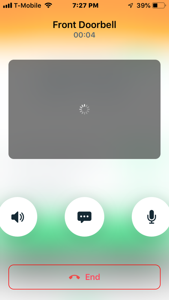

I've setup my Arlo Pro 2 base station, (x2) Arlo Pro 2 cameras and Arlo Pro Doorbell (Model: AAD1001, Firmware:1.2.0.0_275_250). The cameras detect motion and record video as expected but I am unable to see video after answering a call from the Doorbell on my iPhone X. I have tried resetting the Doorbell, pairing and unpairing the Doorbell with the 2 cameras and still only see a progress icon where the video should be displayed. If I look in the library after answering the call from the Doorbell there is only audio and no video. Not sure what I am missing.

Doorbell video
When answering the doorbell call on the mobile phone the video from the paired camera only shows a "gray screen". The camera itself is working in the arlo app. Any ideas?

I also have it paired but still just get the gray screen with the "spinning icon"  in the center as if its trying to get the video but is unable.

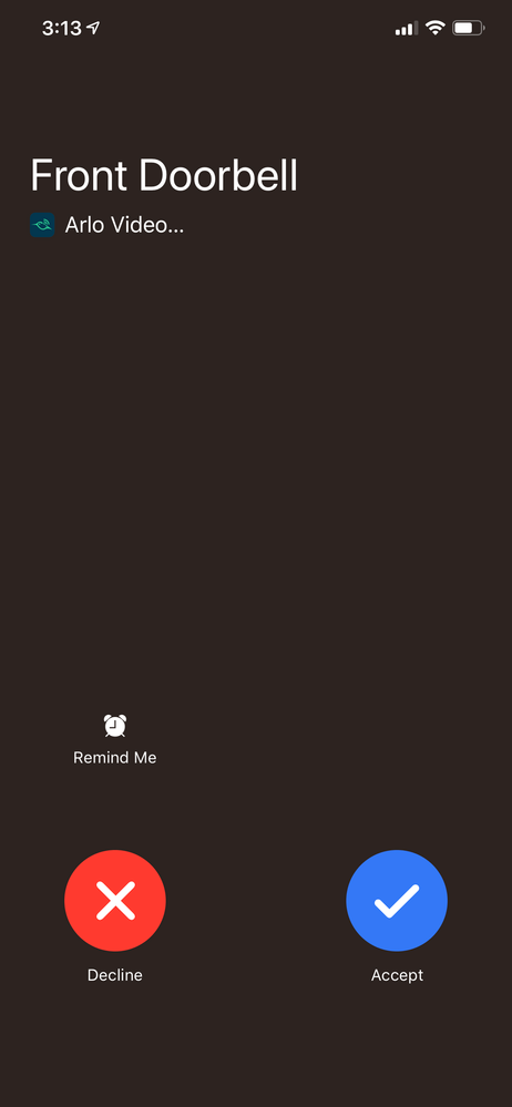

Do you happen to have a screenshot of what the video looks like when viewing?
Message 22 of 147
Re: Arlo Doorbell Model AAD1001
We all seem to have the same issue and the screen looks like the grey square in the original post. Mine works on 4G/LTS and not on WIFI.
Message 23 of 147
Initiate
Here’s what mine looks like.
Message 24 of 147
Initiate
A photo is attached
