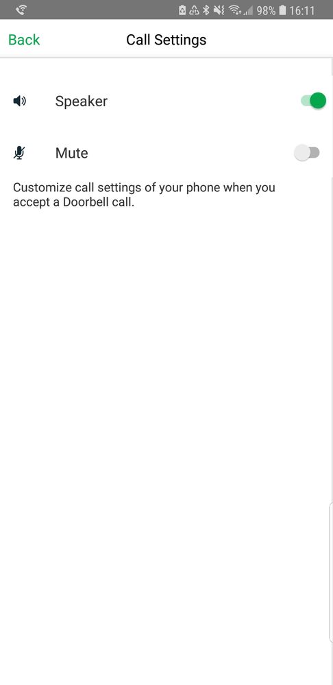

In the Arlo Audio Doorbell mobile app, what is the meaning of the Device Setting "Call Setting" "Mute"?
What does it control?
What happen when it is ON? OFF?
It determines whether the phone mic is muted when getting a call. Not sure why muted is the default.

(See attached mobile screenshot)
In the Arlo Audio Doorbell Mobile App, what is the meaning of the Device Setting "Call Setting" "Mute"?
Apparently the Device Setting "Call Setting" "Mute" is NOT shown on the myArlo webpage, and I don't know why.
Thanks for the help
TomMac
The mic on/off turns off the mic of the phone so the door bell does not pick up phone input... I usu leave the mic off.
 Same thing, diff wording between app and web
Play with it, you can't hurt anything

In my understanding, this does reflect the default settings when accepting a Audio Doorbell call on the mobile.
Here on App v2.6.5_23400 (Pixel 2 Android 9 or Nexus 6P Android 8.1), I don't see the mute indicator is set according to the preset "Mute on".
However, if the settings has mute on, we have to touch the mute button twice before the audio from the phone to Doorbell will become available (by far not loud enough, but that's another issue).
