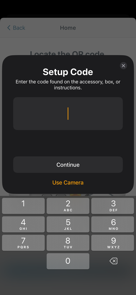

I'm trying to pair a vmb4540 base station with home assistant via homekit and it's asking for a home kit pairing code
My device does not have a homekit pairing code anywhere.
I've seen posts on here that I need to request a token reset. How do I go about doing that?

Followed the directions step by step and still cannot connect. I have the same issue as before. There are no options to move froward from this point.
Use the instructions to set up without a code.
As stated in my previous reply, there is no way around the system asking for a code. If there was, we would not be having this conversation.
Try deleting the Home app and reinstalling it, then following the steps of setting up without a code.
Deleted Home app, restarted phone, same outcome. No option to setup without a code.
Still no resolution. I would like to be able to use the feature that I just spent hundreds of dollar to be able to use.
