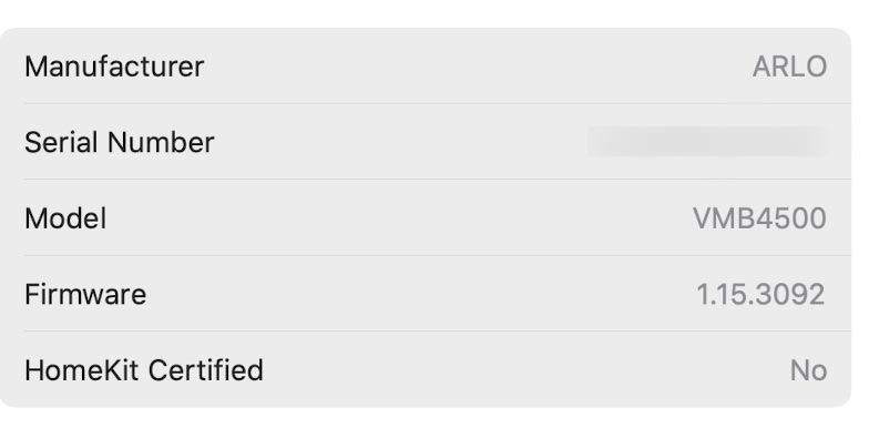

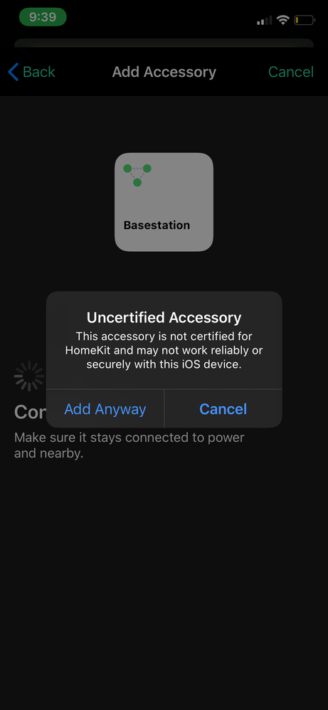

Just wanted to add photos showing the Homes apps certification listing for the Arlo bridge and cameras.
and from the apple site it says they are supported and links go to arlo's web site for purchase
