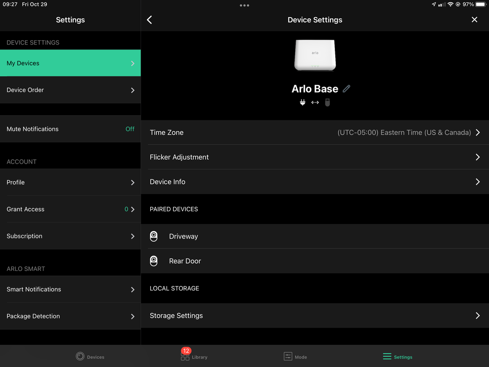

No option. See screenshot.

Read the whole thread and look at my screenshot, there is no option for HomeKit in the app. Anywhere.
Wait! I take that back. Every other guidance said to look in the Arlo app. Found it in actual iPad settings. You are awesome. Now to the next step.
