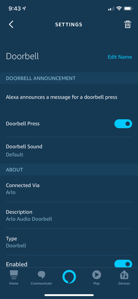

1) The problem is NOT ony for Android users as skingspan described. I have the Alexa app on the iPhone and have properly enabled the "Doorbell Press" option and do not get any notifications via my Echo nor my Echo Dots.

OK. Either I"m crazy or something has been fixed in the app--or the Amazon Echo side of the app--since I first tried to get Echo devices to respond to the Arlo doorbell. Now in the iPhone Alexa app, I can go to Devices...All Devices, and Doorbell. At the top is the name Doorbell, then "Doorbell Announcement" and "Alexa announces a message for a doorbell press", below which is a switch to turn on Doorbell Press. I don't remember this being there before--but, as I said, I could be crazy! I switched it on and now, on the Show, Spot, and three Dots, when the doorbell is pressed, I hear an announcement "Someone is at the doorbell." I guess that's the Default doorbell sound. I havent tinkered with alternate sounds yet, but it is working.

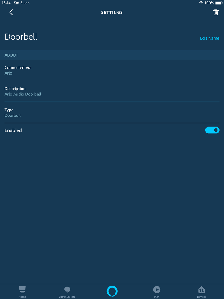

Anounments & it’s toggle switch not listed in Alexa settings for door bell iOS...
Tried all the usual uninstall/reinstall but still no joy..
Would be great to have Alexa working with doorbell in near future, I only installed mine today & moderately happy with it but Alexa bug needs fixing ASAP as was a factor when deciding to purchase this product...
I fixed it by disabling the Arlo skill entirely in the Alexa app. Then individually deleted every Arlo Device in Alexa -> All Devices. Then I re-enabled the Arlo Skill, discovered devices and it found my cameras and the doorbell, and I was able to setup the doorbell and successfully received an announcement from my echo and echo dots around the house when I pressed the doorbell.
I can find door bell in Alexa devices ok, just no door bell press options as is meant to be...
I have tried deleting Arlo skill & Arlo devices & then reinstalling all but still no Anouncements options....
Not sure if I attached image properly but just to confirm,after uninstalling both skill & Arlo devices I’m still not seeing announcements options...the doorbell lists ok in Alexa though..
