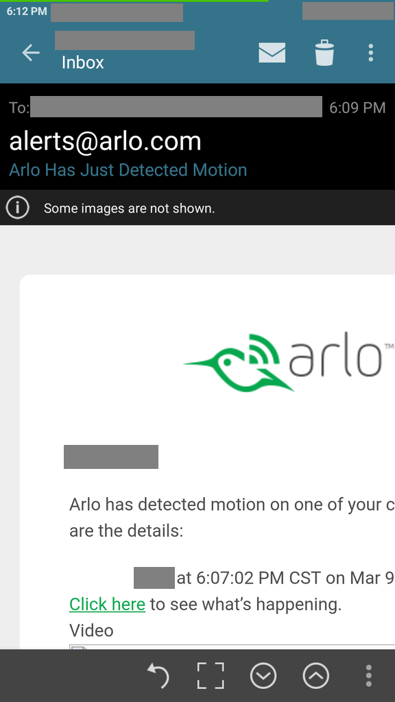

I've set my Arlo Pros to 2 minutes of video after motion or sound is detected. Unfortunately, the notifications arrive to mobile and email not the moment the motion/sound is detected, but after a 2-minute clip has been recorded and uploaded to cloud. This introduces 2+ minutes of delay in notifications!
As per Arlo Pro marketing materials, "View live anytime and receive instant email or mobile alerts whenever motion or audio is detected." Two minutes late is not instant. Arlo is advertised as "Smart Home Security" but 2+ minutes from the motion/sound trigger to notification is far from "security".
Please send the notification as soon as motion/sound is detected.
Here's the proof notifications are 2+ minutes late:
1. Notification delivered at 6.09pm. Email content clearly states motion was detected at 6.07pm. The same time is displayed in the webapp.
2. The same moment the notification was delivered, the video showed up in My Arlo > Library, and was ready to view and download.

You should be aware that Pushes come at the start of the trigger event, while emails come at the end of the recording cycle....

@Judeismyname, doesn't matter. TomMac confirmed email notifications come at the end of the recording cycle which is far from "instant".
@TomMac, and that's the problem, email notifications are far from instant. "View live anytime and receive instant email or mobile alerts whenever motion or audio is detected." As per the push notifications, yes, I realized they actually arrive earlier, around 30 seconds after motion is detected, so not that bad. If only their push notifications actually worked all the time. Email is the only reliable but 2+ minutes of delay for email is very bad

Email notifications arrive after the the detection event because they include a link to that event. This is working as designed. You should always receive a push notification at the start of the event (providing push notifications are enabled and the app is running on your mobile device).
