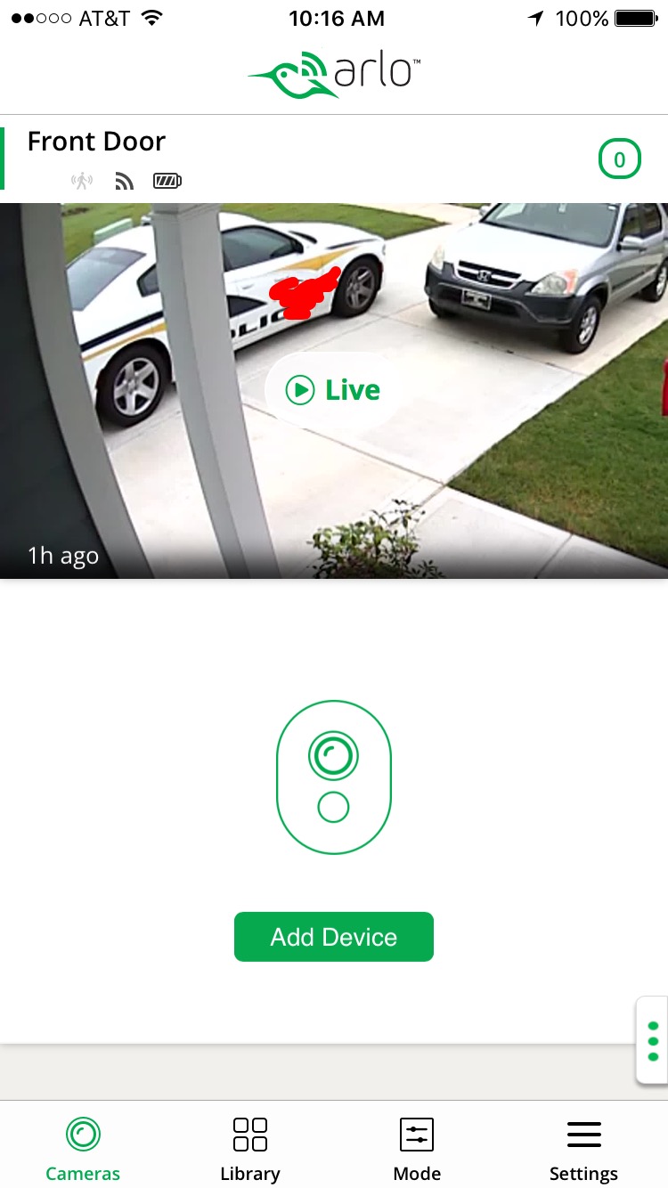

SCBK8893
I am having the same issue except mine is triggering from the flag waving. It will pick up cars passing by but will not record activity directly in front of the house except the flag. Any recommendations? I have played with the sensitivity with no luck im getting ready to just return.

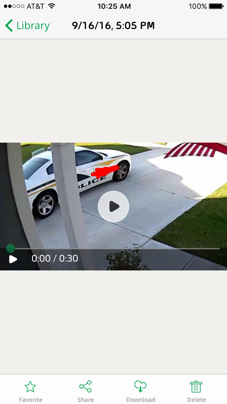

SCBK8893
SCBK8893
This is what the view looks like when the flag triggers the motion.  Any help would be great.IMG_2570.JPG
TomMac
Sorry to say, but it may require either moving the flag or the camera to avoid same.
