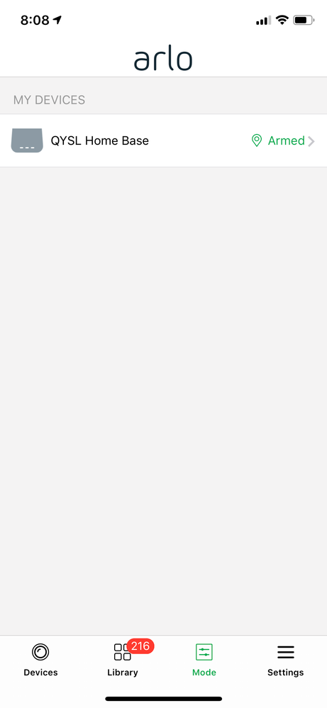

I also am having this problem with 1 device. My iPhone is the trusted device. When I leave home the Arlo will enable Armed. But when I return home it will not disarm. Even when I go on the homes WiFi network. I have to manually go into the app and then change the mode to schedule and click back to geofence for it to disarm. Enclosed is a pic of the WiFi network showing on and the system still showing Armed.
