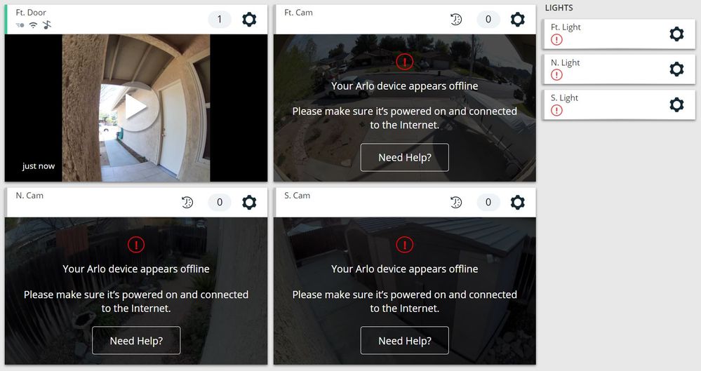

This just started with the Edge Browser in the past week...every time I log into the web portal I get the "Your Arlo Device Appears Offline" message (please see attached screen shot). Sometimes refreshing the screen fixes it but I usually have to login 2-3 more times to be successful. Even when I have the web portal successfully running, in Edge, and go to another open window (Chrome) and come back to the "Edge" window it shows the same "Your Arlo Device Appears Offline" message but seems to refresh itself within 5-10 seconds.
Note that this does not happen if I use the Chrome browser (I use Edge since Chrome doesn't support HEVC for 2k playback) and it seems to correspond with a Windows update that was done at the same time this started as nothing else was changed in my system.

In the two days since I thought this problem was solved, by updating Windows, I am still seeing the same issue although it has gotten much better so now it's not every time I log into the web portal but now it's maybe one out of every ten times (if that) that I get the "Your Arlo Device Appears Offline" message and now if I login again it connects just fine as opposed to it taking 2-3 more logins like before.
Here's something that I now see (see attached screen shot) after my reconnected the video doorbell (also two days ago) via Wi-Fi instead of through the base. In my initial post's attached screen shot you can see that it showed ALL cameras, including the doorbell & lights, not connecting (note that at that time they were all connected through the base) but if you look at the screen shot attached to this post it shows that the Video doorbell (now connected via Wi-Fi) actually does connect while the cameras & lights, which are connected through the base, do not which would suggest to me that the issue lies somehow with the Base/Edge connection (remember it doesn't do this in the Chrome browser).
Internet speed test shows around 90 Mbps download and 12 Mbps upload speeds.
I'm not sure what this tells us but if anyone has any ideas please chime in with your thoughts.
