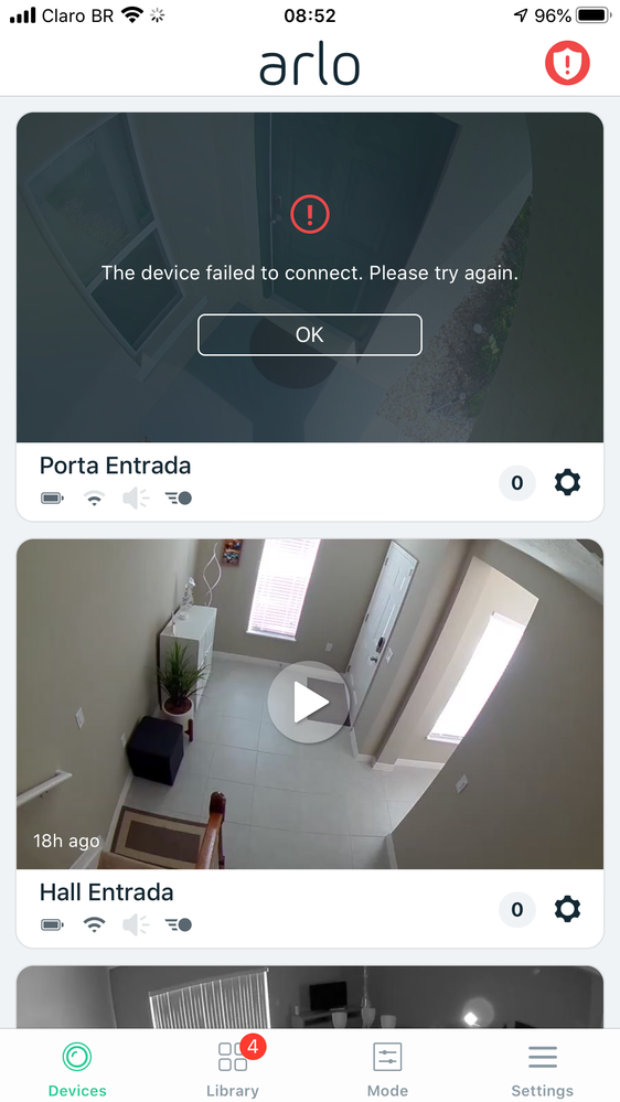

Since April 12, my cameras stoped recording and livestreaming. Keeps trying to connect but times out and gives the message: “the device failed to connect. Please try again later”.

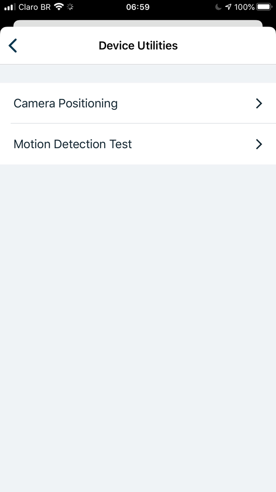

I restarted the base station, but did not work. The only way I can see live is through the device utilities camera positioning. Please need help, as I am overseas and cannot fly back home due to covid 19 restrictions.

I tried turn off and turn on cameras. Still not recording. The camera detecta movement and take a picture not record video. The strange thing is that when I go to device utilities, camera positioning, I can see the live video. Maybe is a hardware problem with the base station.
