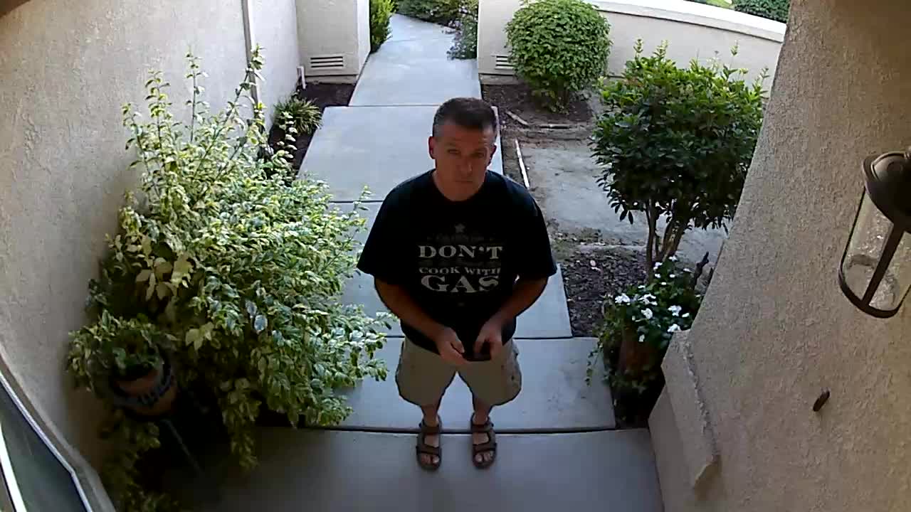

Looking at the pictures & video that I have taken, I am disappointed in image quality. In the picture below I am about eight feet from the camera and quality degrades as I move farther away. It was slightly ovecast so lighting was very good. I have changed the settings to reflect best quality but it doesn't seem to change the quality. I have read others that are experiencing the same issue. Firmware updates are on and they were updated on 7-15-15. These cameras are advertised as up to 720P resolution but these files are not even close to that. What is preventing the cameras from producing higher quality? We really like the system but image quality, to me, is a deal breaker. What can be done? Any input is appreciated.
Larry
First , Did you adjust or change the iris settings for that cam? There are settings for the iris.
Seond, I see that as a fairly good picture.. it's a pretty good ID shot of you and its at 720p... only thing i see wrong is lighting which can be adjusted.
If you needed to use that shot, the PD's i know would take it and correct any lighting and/or overexpose if necessary to make you picture the best quality from what they get. BTW, not changing evidence, just correction of photo is allowable.
It may end up like this;
Honestly... if you want better pictures than above, then maybe you have to go with a differnt system.
Edit;
Remember, this is a fairly wide angle cam shot @ 110 degrees which can cause degrading with distance... one of the give-takes with this lens.

Larry,
If you've adjusted the 'brightness' then you already adjusted the iris setting... was thinking maybe the setting was over looked.
Tom

You may also want to consider adjusting your power management option. By default the system is set to optimize battery life and picture quality. You can elect to set your cameras for BEST picture quality just be mindful that this will utilize more battery power as a result.
if battery life is not as important as the picture quality this setting may be what you are looking for.
To adjust your power management
go to Settings > Camera Settings > Select the camera name > Select Best Video
Let us know if that improves your experience.

I had tried the different quality settings prior to my first post and found no significant difference in the pictures...which I thought was odd. The picture shown above is set at best quality. Is the picture quality that I am seeing really the best that these cameras can produce?
My gut feeling was to return the unit to BestBuy but I kept thinking that I am missing something and someone will point me in the right direction to improve the quality. The camera quality is advertised as high definition but I just don't see it. And I found out that the deadline to return this was last Saturday so I guess I am stuck with it.
Any other recommendations are greatly appreciated and thank you for the reply.
Larry
A few things:
The best resolution is 720p, only about 1 megapixel. You're not going to be able to zoom in and see a gnat's butt.
The lens is wide angle, capturing a scene, not closeups.
And the amount of compression used can severely affect details in the images.
Nothing to be done with any of these. They're built in limitations.

1) You can help ensure that firmware updates happen by going into Base Station Settings and setting the Auto Update toggle to off, save and then turn it back on and save. Reboot the base station and open and close the battery doors on the cameras. It should be automatic after that.
2) Adjusting the iris is done by starting live view and clicking on the "sun" icon on the right. That brings up a slider that you can adjust. Just as with other settings, be sure to save.
3) Exposure and lighting is something you have little to no control over. Daytime uses sunlight and nighttime uses the IR illuminators. The iris is the only thing you can manipulate other than additional lighting you add.
4) After downloading the video, you can use software to edit it but you're limited by the cameras' resolution and the use of compression. You won't gain detail after the fact unless you're using CIA or NSA software. And there's no adjustment you can do to the camera settings to change it other than to use Best Quality in the camera settings and maybe the iris setting.
