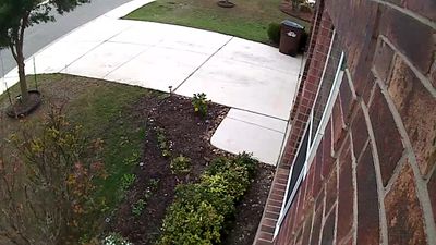

This is how close the garage is to my front door with a circular drive. I have 2 cameras; one at the front door shooting at an angle toward the drive, and the other on the left side of the garage door shooting over the drive toward the front door area. There is no way that my large SUV backing up from the garage and driving forward in front of the front door would have have been outside of the cameras range or view. But no recording was made. Shortly afterward, my husband left and did the same action I took, and his car was recorded.
I still need answers. All camera men are green, no schedule, 24/7 recordings should be taking place. 100% sensitivity.
