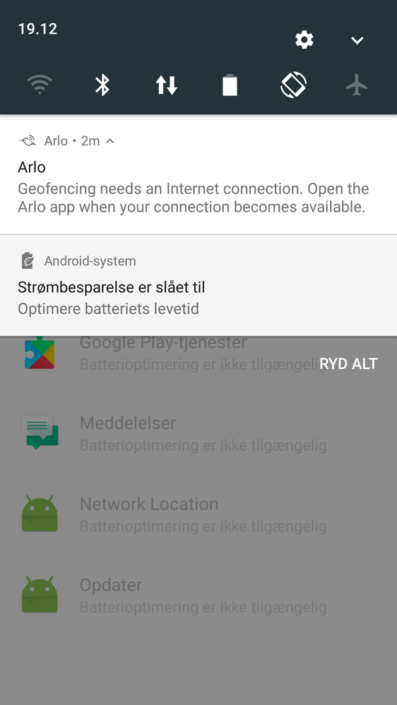

The ful message is "Geofenceng needs an internet connection. Open the Arlo app when your connection becomes available."

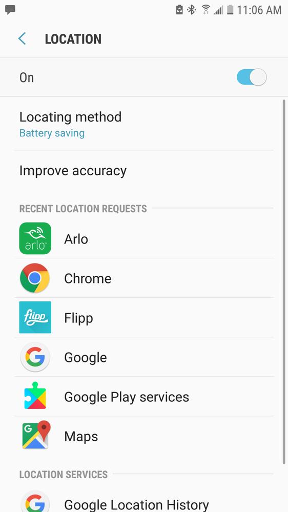

Samsung S7, android 7.0 further details attached.

I keep getting the "Geofencing needs an internet connection..."

Turning off the GPS worked. I assume my problem is when at work the building isn't allowing good signal for data or GPS but I do have phone set to use company wi-fi. But this isn't a fix only a work around. I need to have GPS on for other apps. Arlo needs find a soulution when no signal for GPS, use last know location or need to use all three before Geofencing does not engage (GPS, Wifi and data). At worst maybe an option to manually engage when you get notice and resume when GPS signal returns..

Can you leave GPS on but turn off permission for the Arlo app to it?
