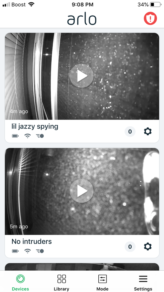

Does anyone have issues seeing clearly at night outside with cameras installed on the inside facing the windows outside?
It's likely the IR LEDs reflecting on the window. Motion detection doesn't work through a window in the first place and the use of night vision just causes glare. Mount the camera outdoors as intended.

@Liljazzy1082 wrote:
Yes my issue is solved .. all I had to do was to turn the night vision off in my settings and now I can see clear through my camera while it’s facing out my window from the inside
The IR lights used with Nightvision will reflect off the glass - which gets in the way.
You'll also find that motion detection doesn't work that well through the window (particularly if the camera is battery powered). Attaching it to the outside of the window is the way to solve that issue.
