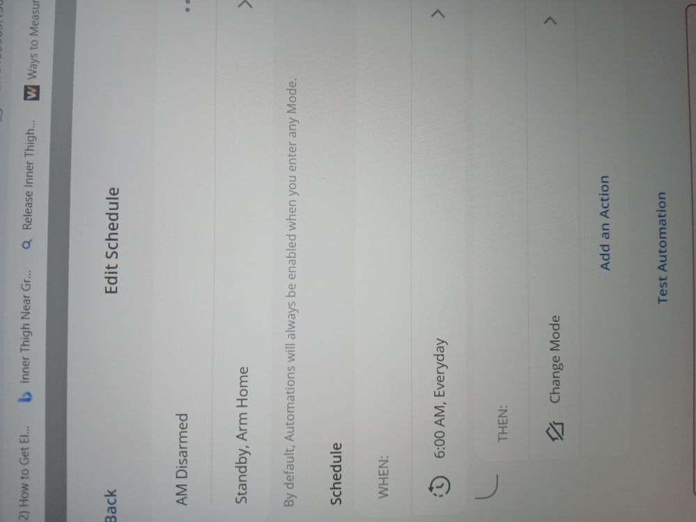

What a pain these Arlo cameras and new app are. I have done everything that was recommended and they still don't work when programmed. I set the cameras to come on at 9PM using Arm Home & Standby. Then I set the cameras to go off at 6AM under Arm Home & Standby. Arm Home & Arm Away has all 5 cameras. The cameras never came on at 9PM and the app shows that it is still in the standby mode. WHY??????????????
Reg
Please post screenshots of your schedule automations.
I don't know how to post screenshots. I took pictures with my phone, but when I upload them, they are sideways and I can't get the right. I'm 72 and not very computer knowledgeable on some things. Please bear with me.

Your screenshots look correct.
To get the schedule to work, you need to kick-start it by putting the system into either "Standby" (during the day) or "Arm Home" (at night).
If it was in "Standby" during the day, it should have shifted to "Armed Home" at 9 pm. You should see this shift on the "Feed" page (saying something like "9:00 pm Arm Home Activated"). So maybe look on that page, and see the transistions to "Arm Home" and "Standby" are showing up there.
