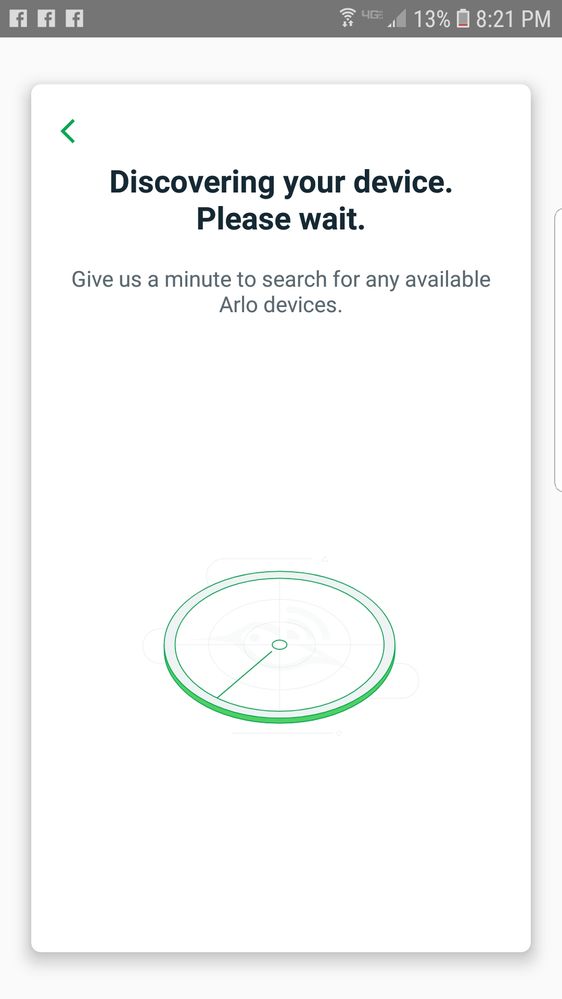

Recently I got a updating request for my Alro, so I did but suddenly my Alro was offline while I was on a trip. I restarted base station but it now working so I removed base station and tried to add again. I can't find it. Internet is connected and I see 3 green buttons. When I tried to search base station it can't find it. What can I do now??
Because the base has 3 green LEDs, your base is already claimed. Start fresh. Remove all devices from Settings, My Devices. Hold the reset button on the base until the LEDs flash amber. Use the Add Device button (web) or + (app) on the Devices tab to claim the base. Sync the cameras. You should be back up.
All bases work with all wireless cameras.
