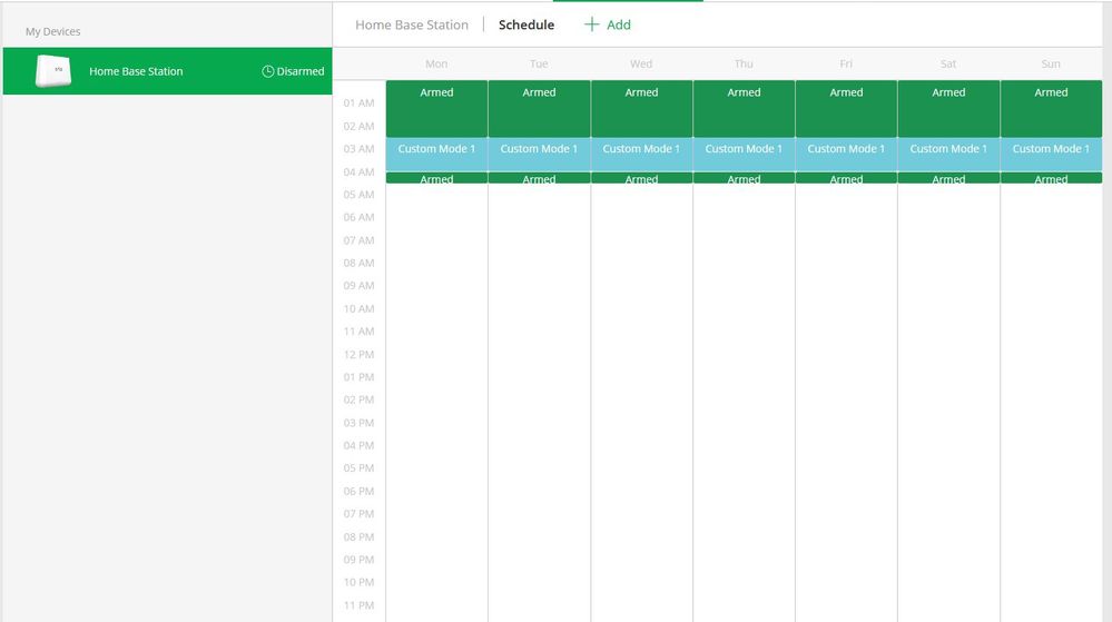

I finally figured it out.
Modes are created for scenarios I want at certain times.
I then go to the "schedule" mode and add the other various modes with timing.
Note the "+ Add" link at the top in the picture below.
Thanks for your help.
After you have created the modes to control the cameras you want active, in the Mode screen there shoudl be a mode called "Schedule". When you edit the Schedule mode there is a button to "Add" that allows you to add a new schedule, and when you click on the Add button, it will show a list of modes (including the ones that you created), so select the first mode to schedule. You then set the days of the week (you can select all of them) and a start time and and end time for that scheduled event. If you want to schedule Mode 1 at night and Mode 2 during the day, you need to add three schedules:
1. Add Mode 1 for every day of the week with start time of 12 AM and end time of 7:30 AM (or whatever time you want) and save
2. Add Mode 2 for every day of the week with start time of 7:30 AM (or whatever time you ended the first schedule) and end time of 6 PM (or whatever you want) and save
3. Add Mode 1 for every day of the week with start time of 6 PM (or whatever time you ended the second schedule) and end time of 11:59 PM and save
Now the Schedule graph should show completely filled in. Go back to the Modes and all you have to do is select the Schedule mode as the current mode and it will automatically operate the other modes you created based on the schedule you entered in the Schedule mode.
Thanks for all your help. I've got it functioning as you described.
