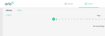

Arlo has been working fine until yesterday. It stopped recording, or at least I don't see any recordings for the last 2 days. I still see them for April 30, but nothing for May 1 or May 2.
I'm still getting notifications on the Arlo app on my phone. If I click on the notification, I can see the recording, but they don't show up in the Library. There is a green dot on the day saying there are recordings, but when I select the day, it says "No recordings". I've confirmed the filters is set for "Any" device. I've also tried filtering by cameras that I have received notifications for, but still no recordings.

I see the same thing on my.arlo.com. A green indicator for recordings on May 1 and 2, but no recordings shown in the library after April 30.
