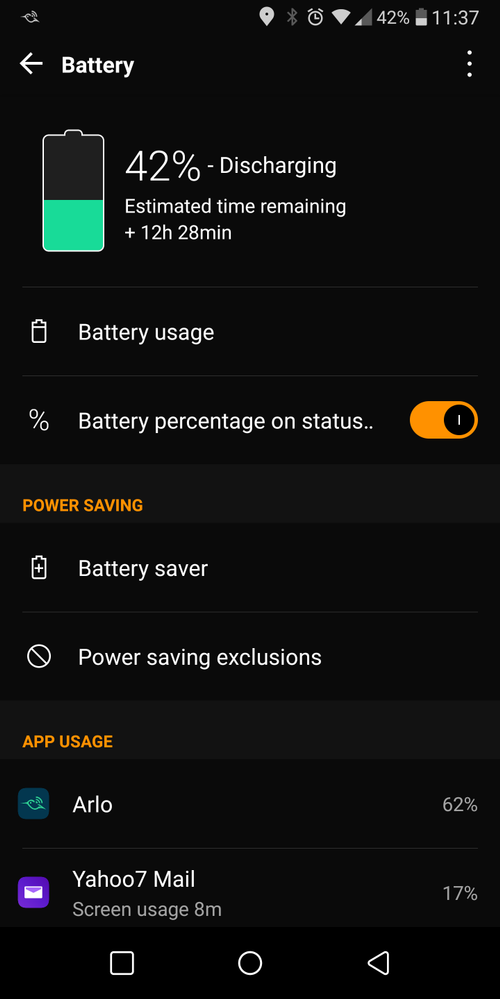

I see almost no battery drain from Arlo with Geofencing off.
With Geofencing on I have seen Arlo using more than 70% of battery. An example from this morning is attached.
LG G6 on 8.0.0 VMB3000 + Arlo/Pro Cameras + App 2.7.9_25600
I ran without Geofencing for 24 hours and the Arlo app is not even listed in App Usage - no battery drain. Below is with Geofencing Activated. Horrific battery drain. I will run more tests. Please add to this thread if you are seeing this problem or have ideas to mitigate.
