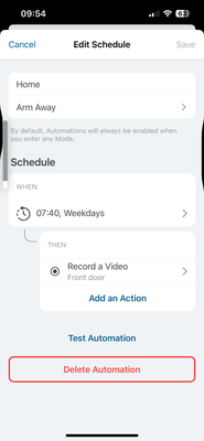

For the life of me, I can't get automations to work on the upgraded app
Since i updated the app, all of the perfectly working schedules are now non working and despite trying multiple times to re-established our required schedules within the automations, it never works and I'm having to manually arm and disarm cameras.

Likely the automation enable lists are improperly set.
Can you post screenshots of all your automations?

I've gone back in and enabled every mode, instead of just the mode I want it to switch to. So its always enable, seems to be working now.
Just can't get the front door camera to activate?

You have three combinations of cameras available to you (one for Arm Away, one for Arm Home, one for Standby). To get the behavior your want, you need to use all three.
- Arm Away to arm all cameras
- Arm Home to arm just the front door
- Standby to disarm all cameras
So the first step is to configure the modes to do this (in particular, modify the rules in Arm Home to just arm the front door).
The next step is to set up four schedule automations to
- switch to Standby at 0630 every day
- switch to Arm Home at 0830 weekdays
- switch to Standby at 1700 weekdays
- switch to Arm Away at 2230 every day
Set all of these to be always enabled.
