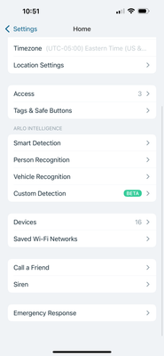

Thank you Brooke. To add, in the latest iOS app, the "HomeKit" option under settings randomly disappears, perhaps it's all related?
Here is a screen shot of where it has disappeared:
And here is a screen shot some time later where "HomeKit" option appears:
