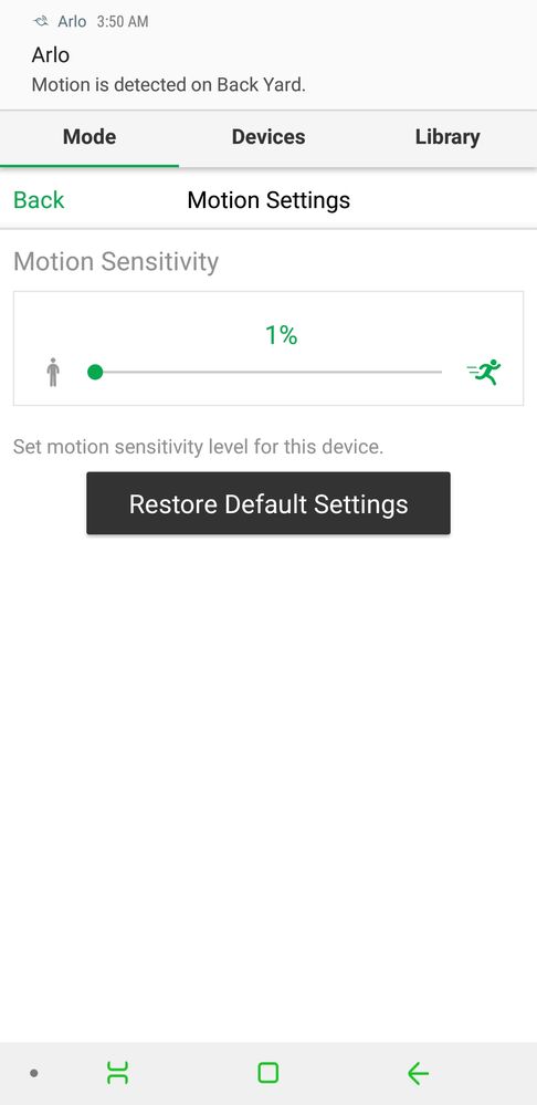

I am having the same problem with my Arlo. It continues to keep going off on motion detection. I have it down to 1% sensitivity, and narrowed down to a part of my sidewalk that has no shadow movements, or any motion at all. But it continues to record and go off every couple minutes. I am really disappointed that you can not reduce the sensitivity down to eliminate cloud and leaves shadows. I am tired of replacing the batteries every 4 days. Anybody knows how this can be fixed please let me know. Thanks
You are changing the sensitivity in your modes and rules, right? The Motion Detection Test is just a way to get a number to put into your modes/rules.
