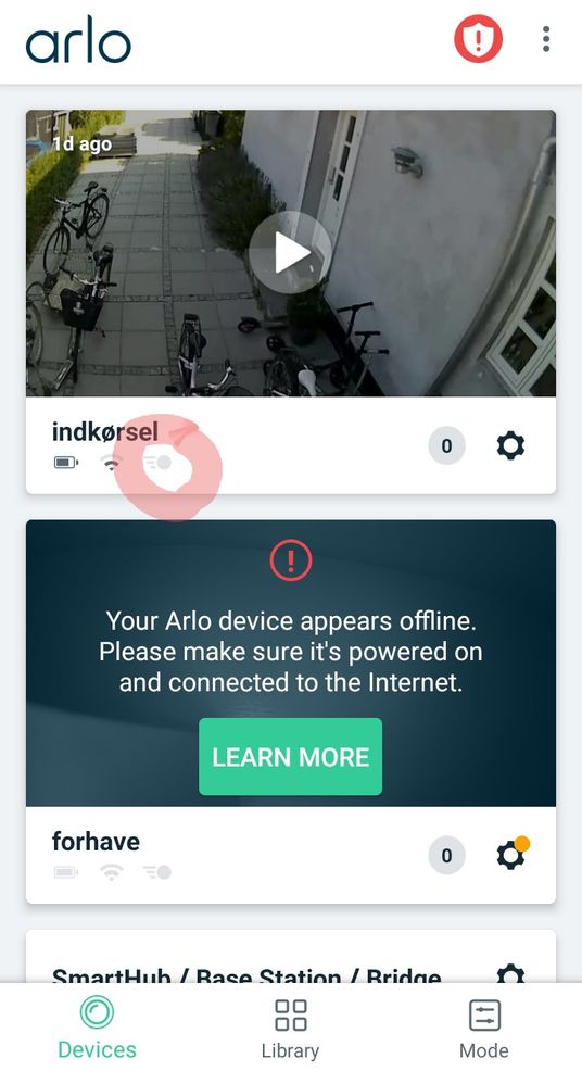

My camera is not starting recordings when motion is present. I believe the grey icon with a red circle on the attached picture should be activated. But how?

That indicates the camera isn't armed. Did you reboot the base? I would also open and close the battery door on the camera to get everything back to a known state. If still disarmed, I would remove and resync the camera.

Great. Can you live stream the camera? Or does that fail?
Have you checked your active mode to verify that the camera has an appropriate rule? Rebooting the base may be useful.
Do you know how to get the grey icon on my picture active?
