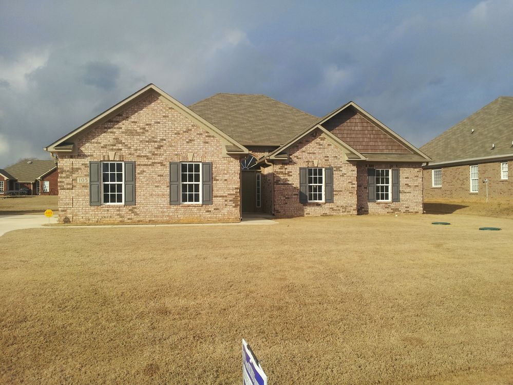

Looking for help with camera best placement for my cameras(2). I think I may need at least two more cameras but want to see how these do first.
Just figured out how to upload pics. Please help advise best camera placement. I have the arlo pro with two cameras.. How many additional cameras do you recommend?
Can't see the photos until they're approved. In the meantime, read the FAQs here, especially the ones about best camera placement. The others are worthwhile, too.
Yes and the cameras are WAY too far away. They may detect cars but people maxs out at maybe 20-25 feet. You want to monitor entry points rather than a whole scene. Again, review the FAQs on best camera position.
For your two cameras, I'd consider putting them as per the red circles in the pic attached. One somewhere near the front door. One at the corner of the building catching cars/people as they come in the driveway or possibly even on the far side of the garage door
I was over-thinking what the pictures meant. You were asking for suggestions as Steve correctly understood.
I'd agree with Steve's assesment although the front door may be an issue since it's recessed so motion will tend to be AT the camera rather than across the FOV. You could use the driveway camera to also trigger the front door one with an appropriate amount of time to allow people to get from the drive to the door. Possibly having a second camera on the front would be more useful.
The back door may be an issue unless there's a tree, post, etc. to attach a camera to. A couple of cameras, one at each end, set up to cross-trigger each other would be most useful. Otherwise, try to determine where motion is most likely to occur and mount a camera so that motion is mostly across the FOV. Trial and error may be needed so consider temporary mounting with an outdoor double-sided tape until satisfied.
