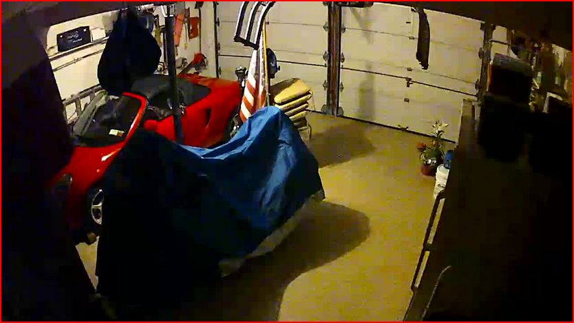

Hi there, I recently purchased the 4 camera Arlo system. I'm using the camera to monitor outside activity, but have the installations from the inside behind windows. This eliminates the possibility of using the nightvision LED. That said, it appears I should be able to adust the light sensitivity of the camera at night using the Brightness setting of the camera. I've tested the values from -2 to +2 using both the Android app and web interface, but it does not appear to have any impact on the picture. I confirmed that the settings SAVED, and start/stopped the LIVE Stream. That said, if you goto the Camera Settings and view the Pan/Scan image, the image is super bright (perfect in fact). Any idea why I'm unable to achieve the same level of brightness using the manual live settings? Any help would be greatly appreciated. I've attached images below. Thanks!
-2 Brightness
+2 Brightness
Pan/Scan Image

Interesting...
Well did some testing in the garage which has only a 60w bulb.... and I can verify what you see...took a clip of pan-zoom and 2 snapshots with changed iris ( not much diff in this light, small change tho can see in car reg sticker, other writing on milk crate, etc )
The only answer I can give is some form of lower compression/higher rez in pan-zoom mode
But I think this needs a higher pay grade for a real answer.
Snapshot off pan-zoom screen ( watch print logo on front of MC cover )
snapshot -2 iris
iris +2

TomMac wrote:Interesting...
Indeed.
TomMac wrote:The only answer I can give is some form of lower compression/higher rez in pan-zoom mode
I don't think it's compression or resolution.
It's simply that the Pan/Zoom mode has a higher EV (exposure value) adjustment setting than the slider on the Live View controls provides.
I wonder if the Pan/Zoom mode uses a different metering mode too, like spot metering, for instance.
Note that the metering mode determines the exposure value (EV) for the given lighting conditions. The manual brightness controls in Live View allow you to offset that value by up to ±2 EV.
In photography/videography there are different metering modes used. Spot metering only looks at the light in a very small spot in the center of the frame to determine exposure, whereas other modes, like Central-weighted average metering looks at more of the whole frame, though still putting higher bias on the center of the image, but a much larger area than used in spot metering.
This clearly needs improvement. Expanding on the brightness adjustment range available in Live View may do the trick, something like ±5 EV.
Someone should perhaps submit a support ticket to get it on Netgear's radar.
