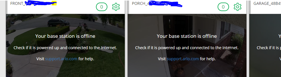

My app is finally keeping me logged in but now my Base station showing offline out of nowhere. My app is now working again but i now i cant get to my cameras. Solid amber light on base station on the camera icon which according to the KB says not connected to internet. My internet is wokring fine and no changes were made by me. Havent had access to my cameras since about 1pm PST Yesterday.

nope. tried to resync one camera. tells me base station is offline. pic attached.
