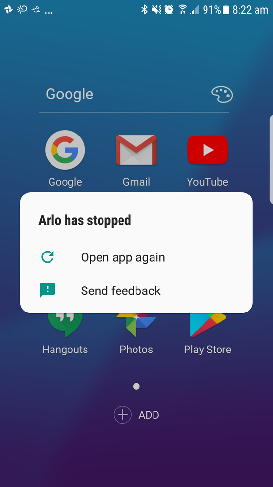

Arlo app keeps crashing everytime I try to open this app. Running on Android with Galaxy 7 edge. Samsung thinks the app is slowing phone down. Screen shot attached. Problems started since late update.
I have uninstalled and reinstalled the app. Problem remained. Anyone else having same issues?

RC0001
Often it crashes, if you are trying to access the app from the notification( after a motion detected). It also crashes 100% of the time if I try to edit any mode/rule. I can no longer do that on my phone. I must need to log via web/pc.
Usually it doesn't show any error msg just gets a pop up saying arlo has stopped. If I want to restart the app or not. I have attached a screenshot.

I am having the same problem with my system. It started about a week ago.  Every time I start the app on my Samsung S9 (Android Version 8.0.0 Build number: R16NW.G960FXXU1ARCC) it crashes.  The app opens and lasts about 15 seconds before crashing.  I am given the option to “Close app” or “Send feedback”.
I am running app version: .4.10_20077
Updated on 26 Mar. 2018

 I have tried uinstalling the app.  I have tried a factroy restore with only installing the Arlo app.  All has the same result, a camera system that I can no longer acsess or get notifications.

I'm having the app still crash when I exit the geofence area. I have uninstalled and reinstalled and confirmed I'm on the latest versions. I'm using Samsung s8+ and I can confirm this has happened on two devices. Anyone else?

I did another re-install last night and setup geo location again and I didn't get a crash as I drove outside of the zone. However it has not armed today so that leads me to belive it was not running in the background. I have rebooted the device yes. I belive this may have actually started around the time of the 11th update. Is there an APK that I can test for the older version?
Sarky1
I have modified my power options to make sure that the S8 is not monitoring the arlo app anymore. I will see if this fixes the problem. I have also the previous version of the apk if the first does not fix it I will try this apk and report back.

I am having this same issue on both of the LG V30's in our house.  After I open the app Geo-fencing will work once.  2nd time I leave the Geo-fencing area the app will crash and not update that I have the area.  I have a ticken open with support also.  So far they have not given any fix.

I'm going on 2 days and multiple entrys and exits of the geozone and no crashes.
I removed and reinstalled the app and then went into the power managment and disabled android from monitoring the power consumtion on the arlo app. I think that might have been what fixed it. I recommend trying this.

I have a Samsung Galaxy S8. When I open my Arlo app, it crashes and I get a screen that says "Arlo has stopped"  x close app or send feedback.  The system is working since I get notifications and when I go on my pc all cameras are functioning.  I uninstalled the app and reinstalled with new download from the google play several times, but the same thing is happening.  What do I do? My system is useless woithoout the app working.

I only have the S8.  I was on Chat yesterday and they couldn't figure it out.  The phone has been rebooted, cache cleared and the app reinstalled several times. Interestingly,  I have poor cell service around my home and when we turned the WiFi off I was able to log into Arlo one time. I tried again and It crashed no matter whether the  WiFi was on or off. This situation is not acceptable. I am glad I have a conventional security system because they couldn't tell me when they would fix my problem. Evidentaly the app has other bugs that cause the same problem that you said they fixed.  It seems it was a very common problem for iOS. If you can do anything to accelerate the resolution of the problem, I would be very grateful. -Scott F.
Sarky1
I can vouch for this most likely being related to network connectivity (Wifi switch to cell and vice versa) I originally thought it was when I was leaving the GPS zone, but the more I let it happen the more I realize It was happening well before the area change. Even increasing the area to confirm my findings. Maybe there is some stagnet TCP connection. If a developer wants to use me for diagnostics I welcome it.

I don't think this should be marked as resloved.  I have the latest version installed (2.5.1_21471) on my Samsung S7 edge and Galaxy Tab A.  Both have just started crashing after this update.  After log in, it stays open for maybe a second then stops.  I have unistalled and reinstalled numerous times.  I have something about going to the App/Storage setting and clearing data which I have done and it still crashes.  However, if I do that and then log in with my wife's credentials, it does not crash.  I then sign her out and sign in with my credentials, and it does not crash.  After "some" amount of inactivity, I start the app again and it crashes.  I thought it might be something with my credentials so I have changed my login email as well as the password (at different times) but the pattern continues. Anyone have any thoughts on helps?
