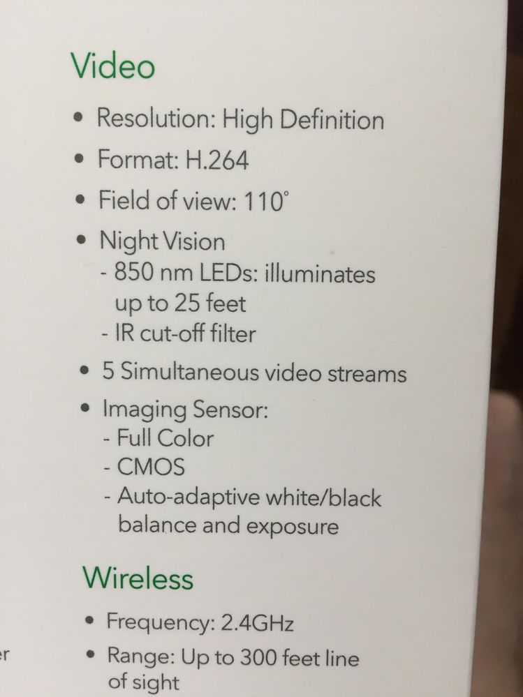

Your solution is completely unacceptable. We find this resolution absolutely ridiculous. As you already know, we have a lot of intelligent people here. So, don't play games with us and think we don't know anything.
I understand that Arlo team has been working hard to resolve the video issue to some extent; however, their solution does not even come close to HD (720) resolution quality.
By the terminology of High Definition (HD), HD must meet the following requirement/spec:
HD is a 24 frames per second with 720 lines (1280 x 720 - 921,600 pixels per image) or 1080 lines (1920 x 1080 - 2,073,600 pixels per image)
All Arlo camera comes with HD resolution as a standard. As stated per their data specification sheet and on their packagings as well. I have attached a photo for your reference just in case your company has forgetten their promise to their customers.
Your arlo camera is nowhere near HD quality. At best, the video resolution is only up to 480 with the latest firmware update. Please send this information straight to your engineering team to research and fix this problem.
As of right now, your company is doing false advertising.

Pixelation has been resolved since the morning of June 5, 2019, but since may 22, 2019, all resolution have been reduced from (HD) 1280 x 720 to (480P) 640 x 352, and there was a slight jerky motion during the live streaming and manual recording.
I understand that Arlo team has been working hard to resolve the video issue to some extent; however, their solution does not even come close to HD (720) resolution quality. HD (720) as stated per their data specification sheet and on their packagings as well.
