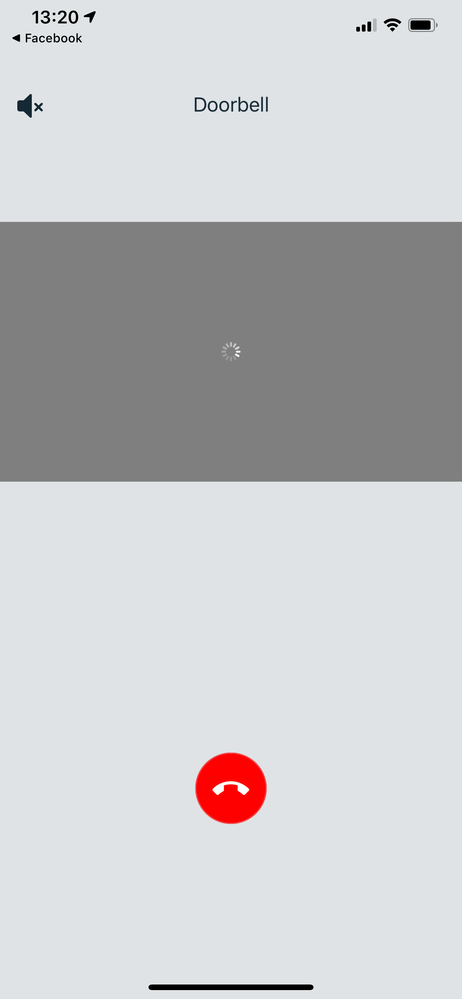

Just wanted to let you know that I purchased the New Arlo Video Doorbell two days ago and still don't have it working. I'm not the best person for doing projects, but this one didn't appear to be that difficult.
When I initially got it installed (it rang my doorbell inside the house) it connected to my internet without an issue and then began to update the software. Well the updated failed and my app showed a failed message. Some of the troubleshoot info stated that I should have a 2.4GHz network (my network is both 2.4 and 5). In spite of that I tried to change the network, then I tried to disconnect it from my network (removing it via my app) and nothing. I then tried starting all over again and can no longer get the doorbell to connect to my internet, so my son decided to press the video doorbell button and it called my phone, but still no video and the doorbell inside my house didn't ring. I probably should have just gotten a Ring doorbell, but though I would be able to integrate the new Arlo Ultra Video Security Camera System into the mix, but from reading your posts, it doesn't look like that's an option.
If anyone has any bright ideas on what to try next, please let me know. I've had a horrible time trying to find a phone number for Arlo, but again from many of the posts I've seen that will probably be futile anyway. Hoping to find help here.
