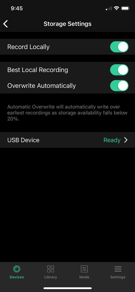

I have local recording turned on. I have a 60gb sd card inserted. I've armed the doorbell to record when motion is detected. I've walked past the doorbell multiple times and when I do I get a notification that the doorbell has detected motion but when I look on my Library tab in the Arlo iOS app I see "no recordings". I have it set to "if motion detected: record video". No video. I've ejected the sd card to see if it's simply stored there (and not updating with a thumbnail in the app) and have not found recordings since I started this troubleshooting process.

I think it's time for a system reset. Remove all devices from Settings, My Devices and start fresh. Be sure to note all settings, modes, rules, schedule, etc. to speed the rebuild.

I've followed instructions you've listed. Since this process I now have the two Arlo Pro 2 cameras recording local but the video doorbell still does not record to the local drive. I receive simple motion notifications from the doorbell but nothing else. I'm working from the default "Armed" mode only.
