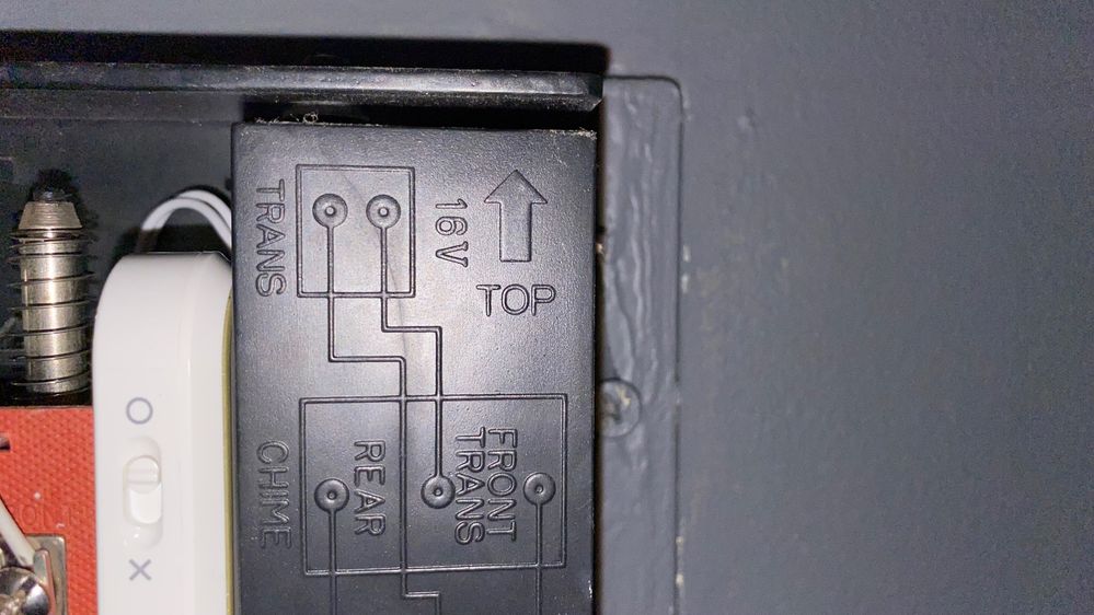

I'm attaching a photo of my chime box where it shows that it should be connected to a 16v transformer. In searching online, I don't see chimes that connect to 24 volts, so I'm not sure if it's safe to upgrade the transformer to 24v without blowing up my chime box. If it's fine to do then I can do it within the next several days, but there's not a ton of info out there on it.

The internal battery is quite small, and the doorbell doesn't normally run on it. It can keep it going over a short power outage, but that's it. It is not user replaceable.
@R5Ryder wrote:
If you're correct about the voltage, first - Arlo should just say that a 16v transformer isn't good enough, and second - is the transformer that goes to the doorbell totally separate from the one in the chime box? My chime box says 16v, and I haven't yet found any replacements that are 24v, however replacing the transformer that's next to my fuse box would be very easy, and I'm totally willing to do that as long as it doesn't cause my chime box to explode.
FWIW, my chime is also rated at 16v, and I use a 24 volt transformer with no problem. Your mileage might vary of course. A mechanical chime (which I have) is only powered briefly when the doorbell is pressed.
As far as specs go, this does depend on the wiring. The resistance in the wiring will result in lower voltage being delivered to the doorbell. So while 16v is what the doorbell needs, it might not be getting that.
Normally there is just one transformer (which can be shared by multiple chimes and/or multiple doorbells).
It is possible to deploy a separate one for the doorbell - using a relay to trip the existing chime. But that is unusual (and not something Arlo describes).

I'd also like to know what the little white box that attaches to the chime is for. I read in a KB article that it is some kind of "bypass", but I've noticed that cycling it off for 10 mins or so and then back on again does temporarily get the doorbell to re-connect and act fine (until it drops.)
A traditional doorbell is a simple switch. When pressed, power flows
- from the transformer
- through the doorbell
- on through the chime
- back to the transformer return
completing the circuit, so the chime will ring.
When the doorbell isn't pressed, no power reaches the chime.
The video doorbell draws power all the time. As a result, some power has to be flowing through the chime all the time (in order to complete the circuit for the doorbell). Chimes generally aren't designed for this.
The power kit is designed to divert power around the chime when the doorbell isn't being pressed (when the switch in the normal "O" position). This completes the circuit for the doorbell. But as far as the chime is concerned, the video doorbell+power kit acts just like a traditional doorbell - powering the chime only when the doorbell is pressed. If you don't install the kit, many chimes will ring continuously (or spontaneously from time to time). Also, there is potentially a safety issue, since the chime almost certainly wasn't designed to receive continuous power.
The bypass mode ("X") diverts power all the time, so it never runs through the chime. In that mode, the chime will always be silent. One thing to check with your new symptoms is whether you accidently left the kit in this mode.
