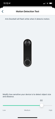

Hi there,
I want to set my motion detection on the doorbell as low as possible as it keeps being triggered.
Often I set to 1 but it will reset to 80 after the motion is triggered. Sometimes my doorbell drops off the WiFi so I'm wondering if that is why it is resetting to 80? I would have thought that it saves this setting even if the WiFi drops out.
Anyone else experienced this and is there a fix?
Cheers,
Goran
Can't see the pics yet until approved. However, it sounds like you're trying to use the motion detection test to set the sensitivity, but that's only a test. Use your modes and rules to set the sensitivity.
