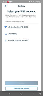

Chime sees all my neighbours 2.4g networks. Won't detect my Vodafone 2.4g which is on, manual connect fails yes typed name correctly which is simply VODA 2.4g. Doesn't see any WiFi extenders which are on the same network. Yet every other WiFi appliance in the house is working seemlessly.

OK frustration over and humble pie served.
Finally found some time to contact support sorted in 5 mins.
In short and it makes sense.
Android in this case.
Switch off mobile data.
Make sure you're phone is connected to the WiFi you want the arlo device to see.
Ensure auto reconnect is disabled for any existing WiFi points so if the phone drops connectivity on a glitch it doesn't auto connect mobile WiFi to another WiFi point.
Reset the unit sync or factory reset.
Voila as the mobilephone is connected to the same WiFi point you want the unit to see (and if in my base the Chime2) will then see the WiFi you want to connect to.
Solved.

as you can see I have 2 2.4ghz WiFi it is dwte ting neither. Seeing my soundbar, neighbours WiFi but not the router.

The Chime2 is simply no longer seeing any routers or WiFi connections within the home.
