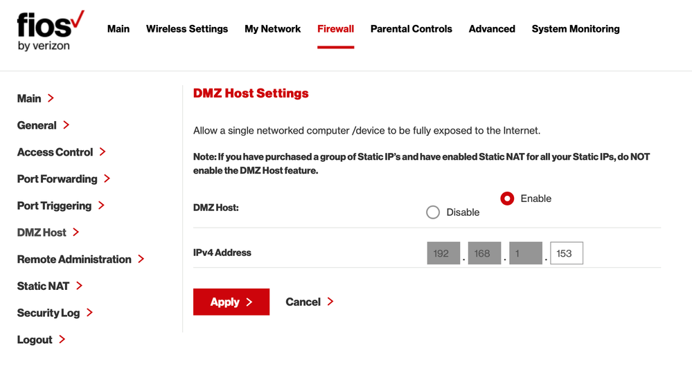

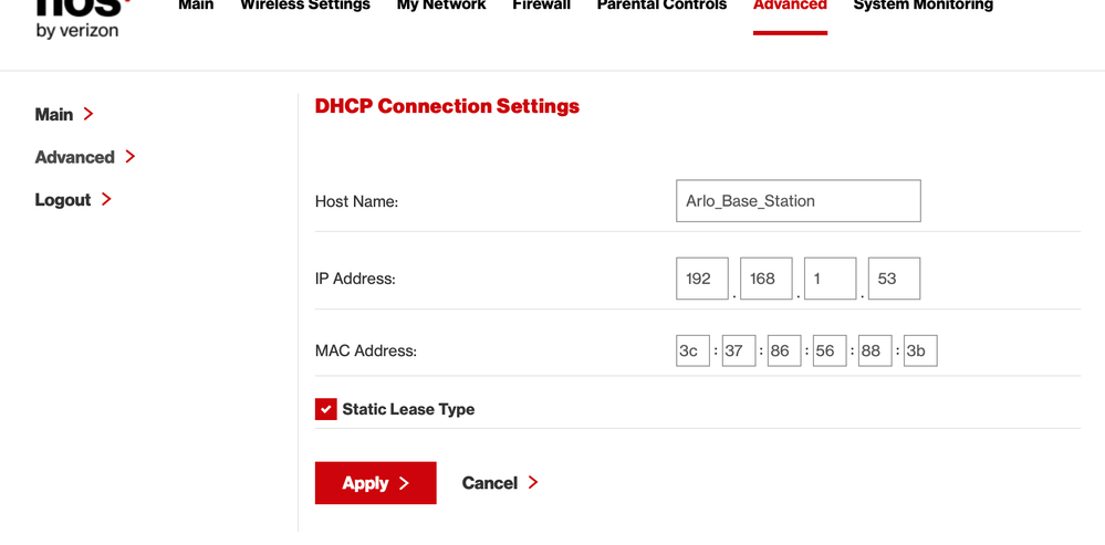

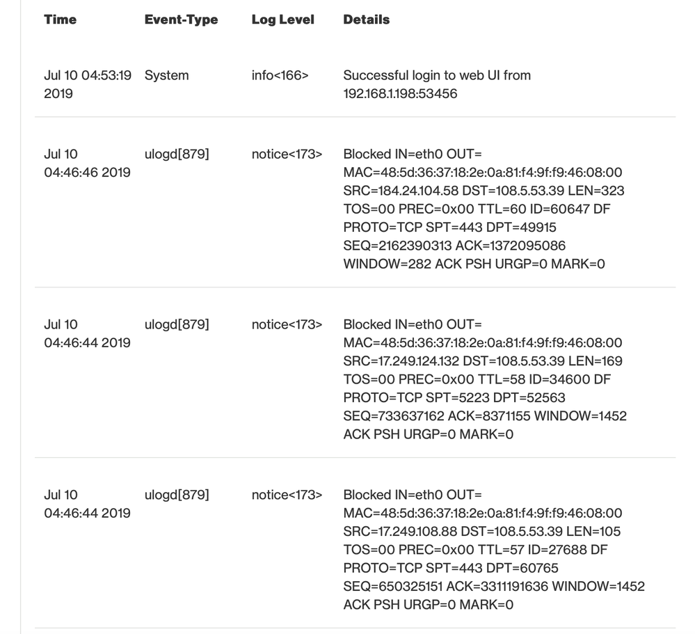

Good evening all, I wanted to attempt to completely rule out that my Verizon FIOS router G1100 is not causing any of my 'getting information' mode issues.
1 - I assigned my Arlo base station a static reserved address in the router.
2 - for testing purposes I added the Arlo base station as the DMZ in the Verizon router
3 - I see a bunch of the same lines in the security logs showing traffic is being blocked. Can someone confirm if that is my cameras? I know the MAC address listed in the security log does not match base station.

(3 screenshots below)
static IP reservation for Arlo base station
Arlo base station added as DMZ
FIOS router security log

Screenshot #1 - Arlo base station static IP reserved
Screenshot #2 - Arlo base station assigned as DMZ in Verizon FIOS router G1100
Screenshot #3 - Verizon FIOS router security logs

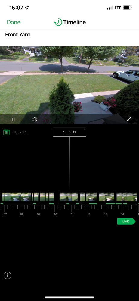

This morning I took a look at my timeline on one of my CVR camera and it looks like Swiss cheese (attached screenshot).
Is this related to my mode switching to ‘getting information’ from ‘armed’.
