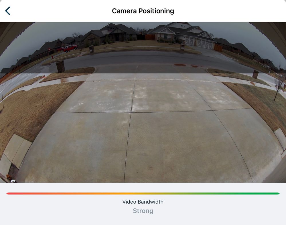

Why is my ultra’s spotlight being turned on when there is movement outside of my designated activity zone? I have designated an activity zone that does NOT include the street (see image below); however, all motion outside of this zone triggers a spotlight (including cars in the street). The problem with this behavior is that every car that drives by at night triggers my camera’s LED spotlight. Therefore, the only present solution is to turn off the spotlight altogether which is not what I want to do! Hopefully, this is a bug that can be fixed!?!? Anyone else having this issue?
blong7699,
The spotlight engages because motion is still being detected by the camera. The activity zone simply tells the cloud not to save the detected motion event in the library. For this reason, camera positioning is important if you do not want the spotlight to engage when the camera detects motion outside the activity zone.

A typical issue is that the camera is pointed too horizontally. Rotating the camera down to eliminate the street would be the fix.
Image of activity zone(s)
Camera utility screen
Why would physically restricting the cameras view (pointing it downward) matter? Isn't the point of activity zones to limit what the camera is actually reporting and recording?
blong7699,
@JamesC , thanks for the response. Your solution helped me, and I’m sure others, who didn’t completely understand the distinction between general camera and Activity Zone movements.
