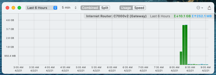

You would think this would be the case, but I'm seeing drastically different numbers. I monitored my bandwidth usage and then unplugged the power to my base station. In the image attached, you can see a drastic reduction in usage once I unplugged it.
@rsox101 wrote:
This is download bandwidth, not upload bandwidth. The base station shouldn't be downloading much of anything, other than the occasional firmware update.
@StephenB wrote:This is download bandwidth, not upload bandwidth. The base station shouldn't be downloading much of anything, other than the occasional firmware update.
I don't know what to tell you, the only change I made was unplugging the base station.
If you plug it back in, does the download bandwidth go back up?
@StephenB wrote:If you plug it back in, does the download bandwidth go back up?
I plugged it back in, on 4/2, and have not seen the same data usage since. I'm going to keep an eye on it but it seems like it was just stuck on a download.
