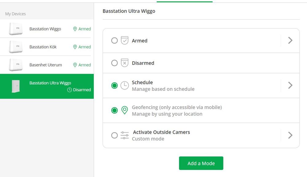

No i also see that the 2 person that i have location on is only one of them correct, but the so called faulty person is correct on the other 3 arlo pro 2 to base stations. I change the geofencing rule to only include the person that has the correct location but it didnt set to the right mode anyway. Does Schedule, GeoFencing and manual created modes work for ultra at all??
Another strange this is, web shows two mode are selected for ultra but only on for all of the pro 2 and if you look in the app only one is active for ultra.
See attached pictures
Yes i have rebooted the base station after above changes, Firmware 1.14.0.7_95_8e49ec9

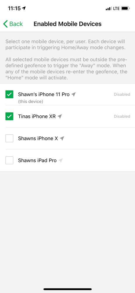

SillySam
Apprentice
Apprentice
Wow here we go again this time Monday morning nothing is working with geofence and nothing has changed on my end sense it worked Saturday...

SillySam
Apprentice
Apprentice
@ jsturess
Sense I talked to you earlier I went and checked my setup and sure enough geofencing is not working once again! I think you jinxed me when you messaged me 😋

@SillySam 🙂
but I think youre problem is different from mine, youre location says disabled. in my case it showing wrong or could not get any information from the devices.
