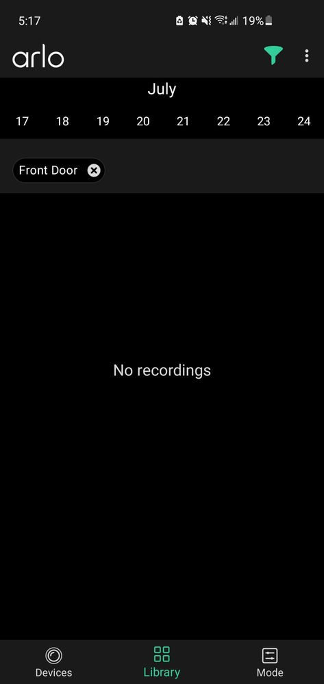

After downloading your new app 3.5.1. I no longer have access to my SD card. I tried rebooting my phone rebooting the base station reconfiguring my port forwarding and nothing works. What did you do with the new app that broke the system again. Sounds like you updated the app once again without fully testing it. I've had Arlo for years and this is not the first time I've seen you people break the system will you ever learn

I couple of days ago my (now 3) cameras stopped listing captured videos on the SD Card altogether - even after rebooting the Base Station and the phone a couple of times, the counters for each camera still show "0" videos - prior to that situation (and after the cloud solution ran out and I installed the SD Card), it would take a few seconds for the "0" to change to an icon that reflected "> 0" counts for the current day - now ALL the videos for ALL the days have disappeared - even though I can tell there is still storage space being used on the SD Card (~0.7 of 32GB). Sometimes, when it was working, I still had to choose "SD Card" instead of "Cloud" when trying to view videos before they would show up - now that optioin has DISAPPEARED!

A couple of days ago my (now 3) cameras stopped listing captured videos on the SD Card altogether
There's a bug in the Android app that was updated on 7/20. Arlo is working on a fix. It is possible to side-load the previous version of the app if you wish.

I lost the possibility to access the recordings stored on my SD card on the SmartHub via the app. Suddenly I don't have the option of switching between "cloud" or "SD card" anymore within the app.
Arlo introduced a bug in the Android 3.5.1 release last week. So if you are using Android, you'll need to wait for them to fix it (or fall back on moving the SD card to your PC and back).
