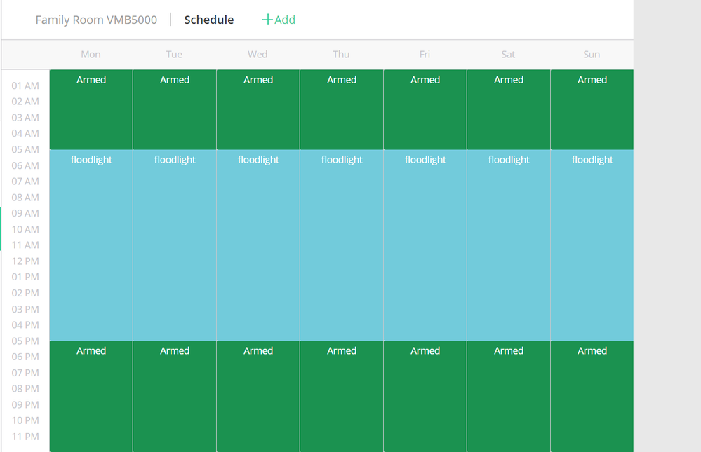

I'm sorry you are finding this so difficult. FWIW, I agree that the settings can be complicated.
Not sure what you are wanting to do with the backyard mode. Your original request was to only have the floodlight running 24/7 and all cameras armed at night. The only custom mode you need for that looks like this:
I happen to have multiple bases - I removed all but one in the above screenshot.
The only schedule you need looks like this:
But one thing this doesn't account for is the two Ultras. They are only armed at night with this schedule. If you select "Armed" when you leave, you will also arm the XLs (and of course the floodlight remains armed). And you'd have to remember to reset the mode to "Schedule" when you return home.
Do you also want the Ultras armed 24/7? If so, the floodlight mode would need also need to include the Ultras. I can provide the needed rules for that if you want them.
If you provide more details on exactly when you want the Ultras armed (and when you want them disarmed), I can provide more info on the modes needed for that (and the associated schedule).
