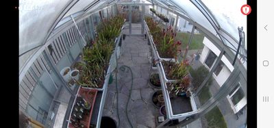

Oh, sorry, one more thing. There is a deffinate difference in the two streams. I zoomed in maximally once with the 4k indicator on my screen, and once without, I took a picture of the same thing twice. Huge difference. Here you can see the difference.
Green screen is indicative of a communication issue. Whilst your base station is and maybe has been in the same place for some time now, users (not necessarily you, but maybe your neighbours) introduce more devices that interfere with the WiFi signal, such as big metal objects etc. etc. This can affect the signal quality. Therefore, you should bring your base station closer to the camera for testing purposes and see if this improves the stream quality.
Good advice, thanks. At least it works again, and if for some reason the 4k stream no longer works again, I'll have a work-around!
Thx for sharing, I agree there is a clear difference.
Here is btw where I use my cam. In my greenhouse where I grow carnivorous plants.❤️
