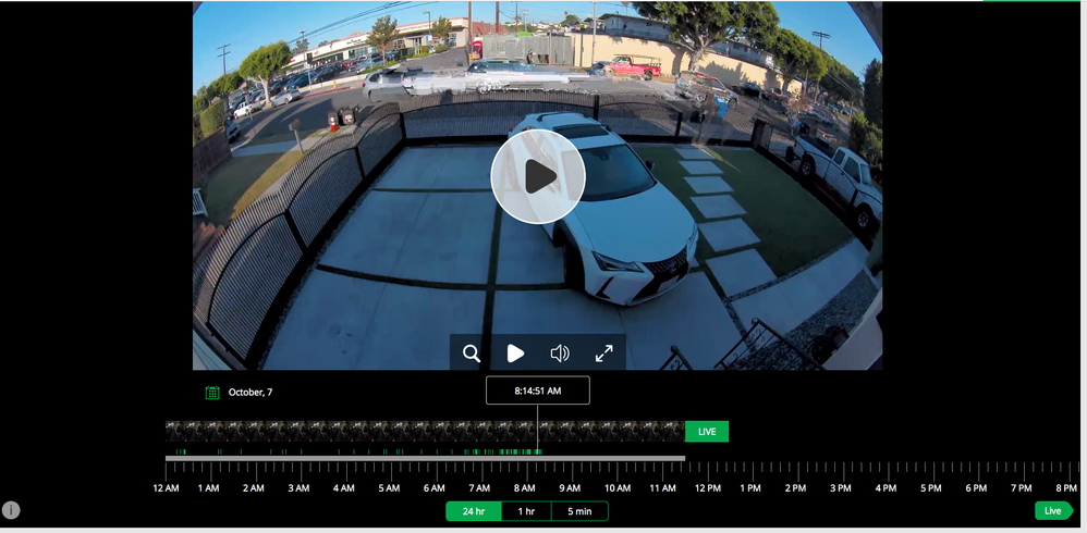

After several hours with tech support, i've learned this about the Ultra system:
If you use CVR on a ultra camera, regardless of your network connection and camera proximity to the base station, after a short about of time (im talking a few hours), the camera will stop respecting activity zones. Then, the footage will have so much artifacts around motion, that entire people start to blur into noise and blockiness. Image attached at bottom of post.

I've found the solution and it indeed is with the CVR. I've restored functionality to my Ultra camera, but it cost me turning off CVR. After turning off CVR, respect to activity zones are restored, the camera becomes stable, and the footage looks clean. I then upgraded to PVR (4K) footage in the cloud to stress-test the ultra, and the results still hold well.

Arlo Ultra CVR is broken. With current firmware, CVR will cause you hundreds of mis-fired notifications and dramatically terrible footage that is not useable in ANY respect. Im not being dramatic, but people within 10 feet blur into a block mess and you can barely see the color of their t-shirt.
