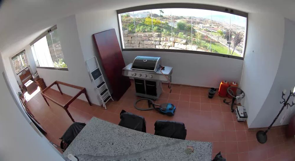

As you can see (hopefully) in the attached pic, this is actually a long terrace on the side of my house. When I enter the picture from the far side the motion detector doesn't register motion and begin recording until 10 feet away (even with sensitivty on 100%). So my idea was to put a motion detector at the end of the terrace and create a new mode that when the motion is triggered it will start recording. I read that "Arlo’s ambitious 2019 plans include home security devices, and HomeKit, Zigbee, and Z-Wave support" (and Apple, which oddly isn't in the headline). But I guess those are not linked in yet and Arlo has no motion detectors of their own?
@ExpatEU wrote:When I enter the picture from the far side the motion detector doesn't register motion and begin recording until 10 feet away (even with sensitivty on 100%). So my idea was to put a motion detector at the end of the terrace and create a new mode that when the motion is triggered it will start recording.
In the absence of a standalone detector -- a door switch would be good -- as @JamesC says something like an Arlo Security Light would work. I have done that.
The light does not have to come on to trigger a camera. The light would also be useful at night.
