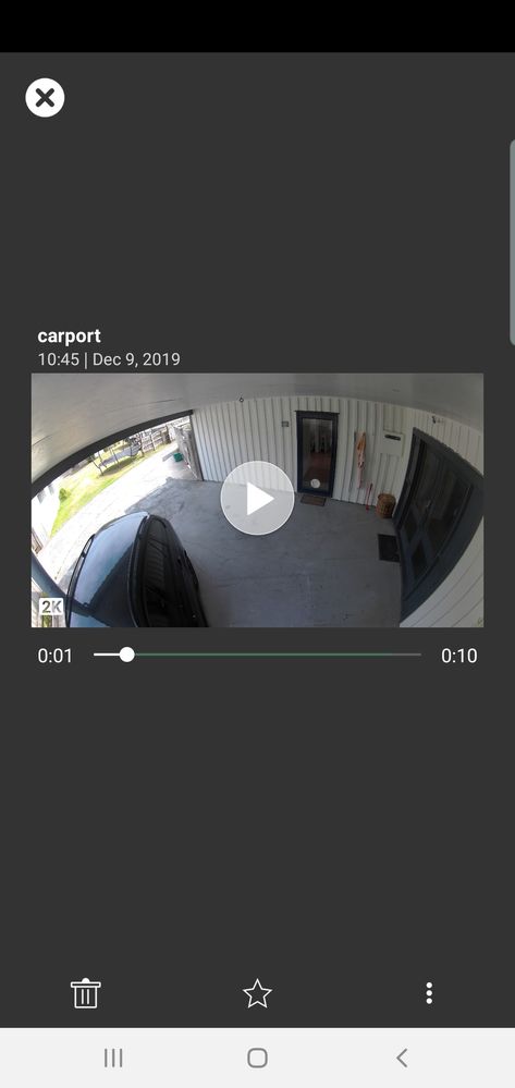

lindejoh
Only records in 2k. Why?
Community Manager
Community Manager
This issue is resolved with the latest version of the Arlo mobile app. Please make sure you have the latest version installed from the app store and let us know if you still experience the same issue

StephenB
What base do you have?
lindejoh
Ultra Base
StephenB
Without PVR it will record at 1080p, but it shouldn't be recording at 2K (2560x1440).
lindejoh
I have PVR subscription on the camera, so I should get 4k
StephenB
Yes.  Are you seeing a 2K label on the video in the library?
If not, can you confirm the precise resolution you are seeing in downloaded files?  One way to gather this is to use MediaPlayerXP (windows only).
lindejoh
I see the 2k label on the recorded videos
StephenB
I think you should contact support. https://www.arlo.com/en-us/support/contact.aspx

lindejoh,
Are you able to provide a screenshot of the 2K badge you're seeing? Can you share a clip of this as well so we can take a closer look at the issue?
