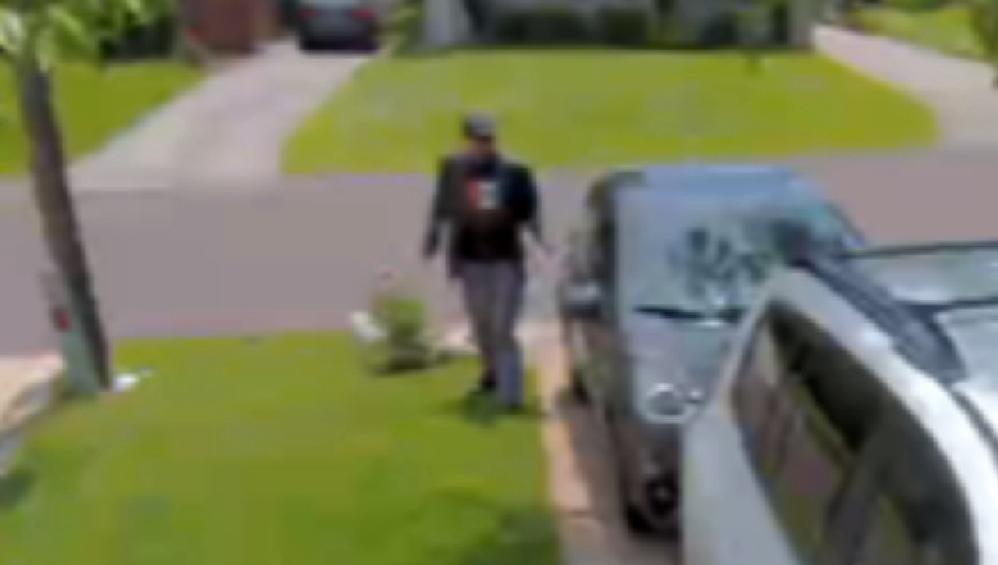

I have the Arlo Ultra 2 Cam kit and can't seem to get 4k with this camera. Mounted about 8 feet up on garage and the video resolution is terrible even 10 feet line of sight to camera. Cannot read license plate at 10-20 foot range. screenshot of video included below.
I have checked the settings in the Arlo app to ensure all are set for 4k as follows:

For playback I have used several apps. On my iPhone 8+ I have the latest IOS 12+ and using Safari which is documented as supporting HEVC/H.265. When using local streaming, there is a 4k icon in the top left. I have also removed the SD card and copied the mp4 files off of that to view on Windows10 with an updated codec for HEVC/H.265. The initial picture looks good, until trying to zoom in on a person or license plate and within 10-15 feet the picture is really breaking up and low res.

Define poor. Host a video someplace and give us a link to look at so we can see for ourselves.
Have you checked the video details to verify the resolution? WHen I downloaded it from your page it was 720p which would seem to be due to the quality setting for your camera although it could be something about the website changing it.
ALso, remember that the lens is a BIG fisheye lens so zooming in and expecting detail from a distant object is not gonna happen. Add in the compression and you lose more detail.

4. The video posted to the web site is unaltered and copied from the SD Card. It is possible that the web site is porting it down to 720p. However, when I look at the video I posted on the web site, that is the same quality I am seeing on my phone on local network and when I copy from the SD Card and view it on my computer on a 27" monitor with 2560x1440 resolution.
5. When viewing the details of the video clip(s) - the res is 3840x2160 / data rate 3915 kbps / frame rate 18.75, etc. The resolution is there, the camera just can't make out detail even at short distances and is not performing as advertised.
Also, I do a lot of video editing and camera work and even at 720P, I should be getting a better picture. Either I'm missing something or the Arlo Ultra camera's and base station are not able to provide the quality that is advertised. Also, a person at 10 or 15 feet away is NOT a DISTANT object as you are stating in your response. I'm aware of the compression issue and losing detail.

720p is <1 megapixel, 1080p is 2MP. Add compression (compare file sizes with uncompressed videos). Depending on what angle you've chosen for the FOV, it's still like a 15mm full-frame DSLR fisheye at best, probably more like 5mm at the widest. Details are hidden because of all of this.

However, just like the original poster, the pictures are clearly not 4k and I cannot make out any detail whatsoever, even 6 feet away when I zoom in. Pretty gutted about this as it is not what is advertised.
Compare yours to mine (attached). Do you see a difference?
https://www.dropbox.com/s/12y9plznjrdkd1x/2019-05-25_124619_Ultra%20playhouse.mp4?dl=0
No difference really. It looks good until you zoom in on something, like the trash can lettering. The squirrel was interesting.
