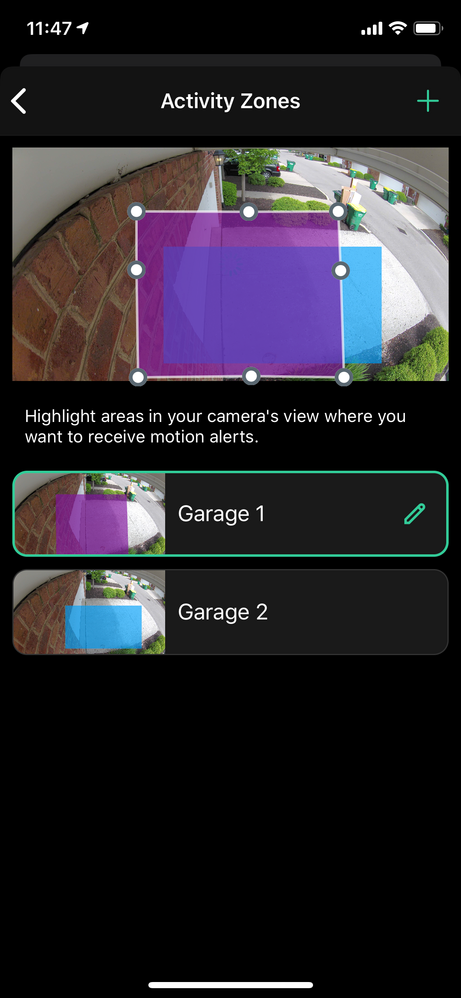

Glennny
I’m still having issues with the activity zones not working correctly on my arlo ultra camera. I’m getting alerts outside of my set activity zones which is leading to 50+ alerts a day.
I see this was a problem back in December but I have all of the latest software versions and it’s still doing the same here!

This doesn’t sit right with me...this clearly is an issue, posts about this problem going back years. Is it just me or does it seem it should be more simple than it is. Activity Zones should send you a notification when something crosses into the zone. Boom. Period. Should be pretty cut and dry. But the only answers we get are oh adjust your sensitivity setting, oh there’s been a firmware update, oh their working on it, change the position of the camera to exclude the area you don’t want notifications. blah blah. Then what the heck are activity zones for!?! I don’t understand how programming engineers can’t get it right, just exclude what is outside of the box drawn on the screen. I have a brand new system, I’m seriously considering returning the 10 cameras and outdoor mounts, and solar panels I have because I’m very disappointed about being misled. I have a house which is close to the road and the cameras in front and the side of the house have no other option but to include portions of the road in their field of view. It’s impossible because of the angles to exclude them. Nor do I want to. Nor should I have to because they’re are ‘activity zones’!! to handle this issue!!! I was sold on activity zones being able to draw a line on the edge of the road along my front yard and driveway/parking lot so that it wouldn’t send me notifications on traffic passing by but should someone pull off the side of the road into my driveway they would trigger an event. If the town ever wants a traffic study done on my road all they need to do is ask. I can tell them exactly how many cars come by in a day. I’m highly annoyed at what seems to be a lack of interest in Arlo engineers actually fixing the issue. Don’t get me wrong I appreciate the suggestions from customer service but the bottom line is none of these suggestions solve the problem. End rant.
KB33803a
Just installed the system this week and I'm experiencing the same issues as others seem to be having with Activity Zones.  It seemed to work kind of OK when I first set up the activity zone.  But, when I resized it to eliminate cars going by, it seems to have gotten worse.  I've tried changing it to only alert when people are detected and that changed nothing.  As it is, I disable the camera except at night now...it's worthless in the day for my front yard and porch.
