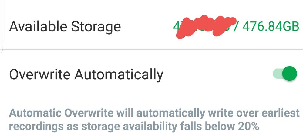

I have.512gb work perfectly on ultra.However,the size is not the problem,battery drain is much bigger problem even i install the official solar panel for ultra.In a single day , my battery drain from 52 down to 30 % ,solar panel only charge roughly 10 % a day.Now,i have to limit the recording period only in the late night time.T_T.(normally , if you use all 4 cam in your house and set it to ARM ,for me, i use about 4 gb per day for recording.(I live in town ,2 of my cams are in the front of my house which have so many people moving around all day and night)
That's what zones and either Arlo Smart or AC power is for. Additionally, rotate the camera down to eliminate more of the busy parts of the view and concentrate on what's truly important. Post screenshots of the camera view for suggestion.
I'm using a 512GB memory card.

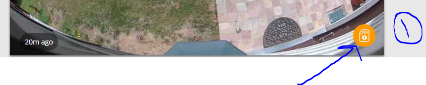

But it has format issues. keeps asking for regular format every week.
I might try to use lower capacity memory card later. as this format request, every week is annoying.
