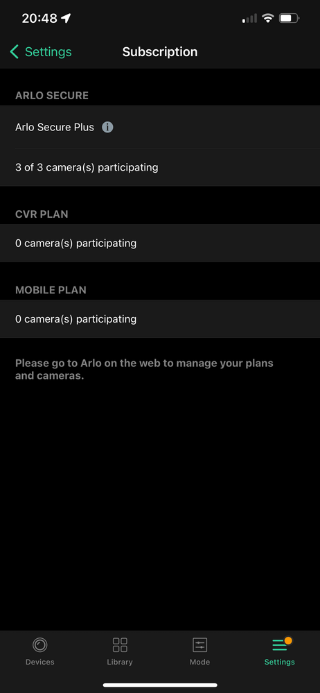

Do you have a screenshot of your plan details under Settings > Account > Subscription?
MarkCal
