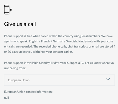

1. The "give us a call" section is missing a phone number for EU:

3. So I opened a support case. The system acknowledged the ticket and was supposed to send me an email with the confirmation. No email arrived. Seven days later still no one from Arlo contacted me and there is no other way for me to contact Arlo. Not very reassuring for a security company ☹️
